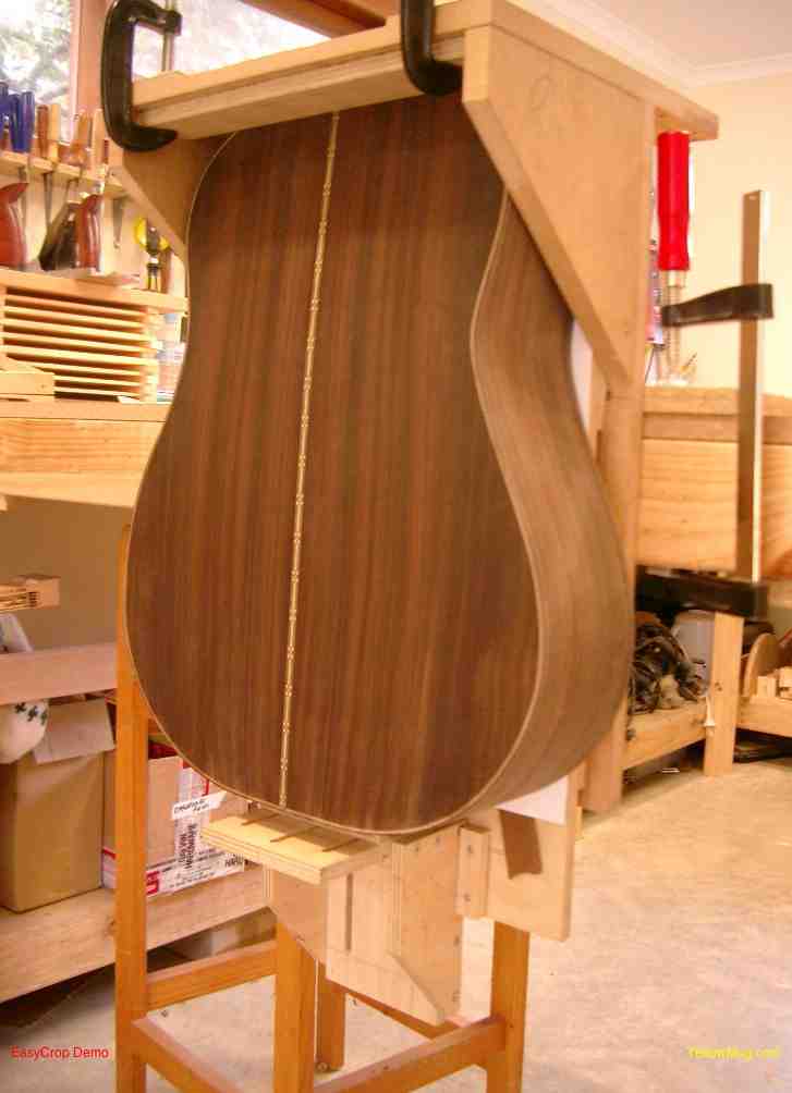

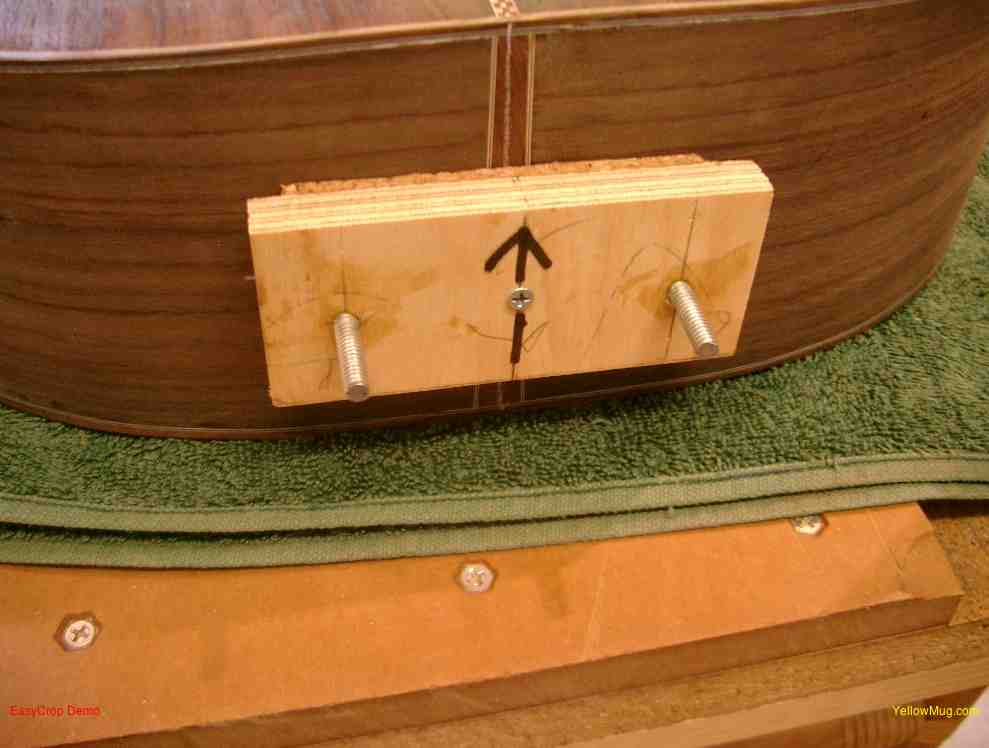

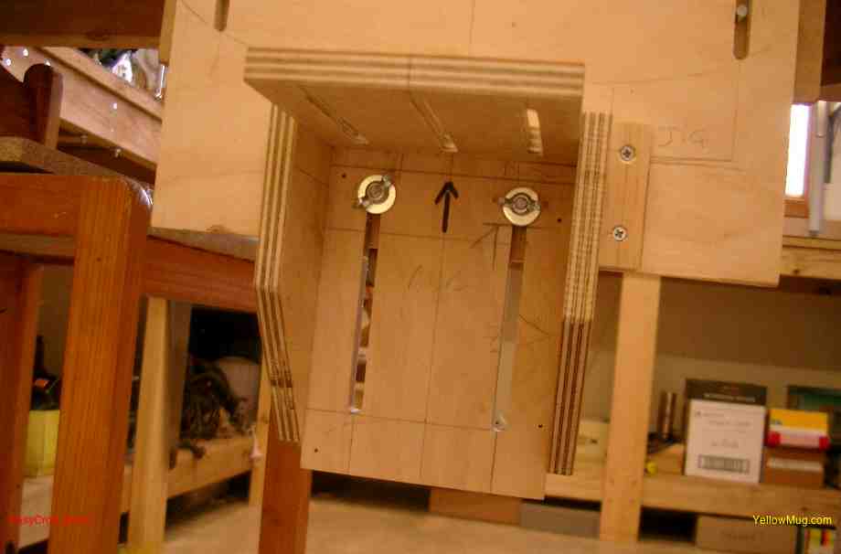

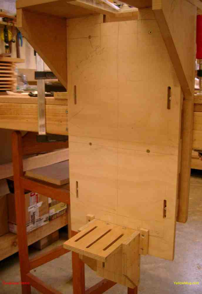

Pics of the end result of a week of brain storming and problem solving. The clamping arrangement for the upper bout is a temporary arrangement and will be modified.

PostPosted: Tue Sep 05, 2006 4:40 am
Martin,
Nice jig! Thanks for posting.
BTW, could you edit your post so your pictures line up vertically? Thanks.
PostPosted: Tue Sep 05, 2006 10:19 am
Posts: 1055
Terry,
The end support mainly holds the heel end of the guitar hard against the top of the jig. The guitar can still move a bit due to the arch in the top so I adjust until everything is square (there are registration marks and lines all over the jig and on the template) and then insert a few wedges between the top and the face of the jig.
